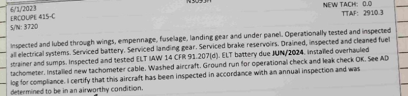

If one of my mechanics brought that to me, I would make him redo it. not doing a complete entry is just being lazy, I bet his AD sheet sign offs just said C/W.

An AD status sheet, such as those created by a AD research program is never a official part of a logbook, it is sheets of paper that can be removed and replaced, unlike logbooks pages. A AD list is good to see what ADs are in the logs and when they were done, but most AD sheets I have seen, the IA who prepared it, signs off everything on the sheet, so is he signing that the AD was done or that he did them? The AD that is listed as part of a logbook entry and has the information required by FAR 39, is a legal sign off.

I'm not an expert on these things, but I will point out that since the airworthiness log entry statement makes reference to the AD Log, that log is now part of your logbook. You may have several logbooks anyway (airframe, engine, propeller) and now you have one more to keep with your logbook collection. The AD logbook should list every AD with a sign off by an A&P

Thanks for your reply. I went back and re-read your article. I just bought the airplane, my first. The last annual was done by the prior owner. A copy of the logbook entry is attached. I assume you'd find this logbook entry deficient?
I don't want to insult the AP/IA who did it because I might need him for the next annual. Would you recommend I ask for an updated logbook entry; ask for the AD sheet so I can see what was done; or let it go this time?
Thanks for your help!!
