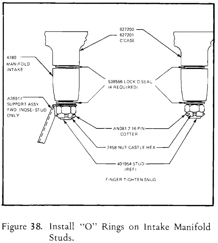

I won't be able to get to the hangar today (change of plans at work) but I did dig up some information that might be useful.
Here's a photo from the engine overhaul manual about the "Seal-o-Lock" aka "Lock-o-Seal" aka "O-rings" for the intake spider mounts. Univair has them listed here with a photo. You'll need 4 of these, and the overhaul manual repeatedly states that the castle nuts should be finger tight only - and even states "Do not use wrench on castle nut. (See Figure 38.)"
You can download the overhaul manual here . The above information is from page 103.
I remember putting mine together, and I can imagine that if enough time passed and the rubber part of the Lock-o-Seals perished away, the intake spider would feel pretty loose. I'd be interested to hear what you find when you take yours apart... was it just loose, were the studs backed out, or was the rubber worn away?

The intake spyder uses "lock-o-seal" washers (see parts diagram) and is to be tightened "finger tight" (see Continental maintenance/overhaul manual). That allows the carb to slightly float with engine vibration and not have the sloshing mess up the float level. I found that the shop on one of my annuals had really cranked down the mounting nuts, preventing that play and had it corrected with new lock-o-seal washer and proper tightening.
