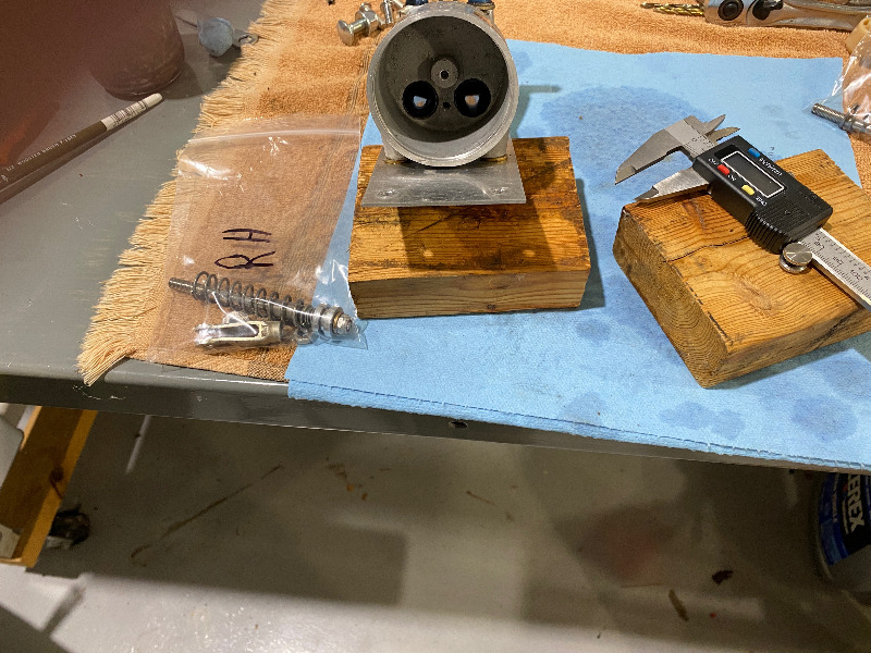

So I thought it was best to add the following to this discussion.I believe this brake master cylinder and reservoir is only applicable to the Mooney M10. Possibly a few later production A2As, but I do not know. It is a nice, compact unit that for some reason not very popular despite how popular Gerdes brake systems are. Good luck finding any sort of literature about this unit, let alone a rebuild kit. I recently rebuilt this master brake cylinder a few months ago, and found the following o-rings to be the correct ones:MS28775-006 quantity two for the parking brakesMS28775-008 quantity one for the reservoir cap boltMS28775-009 quantity two for the piston seals (most important ones)MS28775-010 quantity two for the exterior of the piston rodsI was surprised how “dirty” the accumulation of gunk within the cylinders despite changing some of the hydraulic fluid over the last 5 years. If you are having some brake issues and have already changed out the caliper piston seals and fresh hydraulic fluid, I suggest removing this unit and cleaning it. Take your time and take pics because there is no reference literature, but it is not really that complex.The reservoir cap, I just used a very light coat of RTV as a gasket, and let it set for 20 minutes before assembling. Let it sit overnight before adding fluid.
Hope this helps someone….Mike

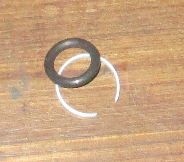

Hi Scott,
Sorry for the long time but at least I come with a solution!
First of all forget mention of rubber coating supposedly damaged. Wrong track.
A friend of mine very experienced in aircraft maintenance looked at the "composite" seal found around the pistons, it combines a conventional O-ring and a very flat section seal probably made of Teflon (on the photo this one has been cut to disassemble it without damaging the edges of the piston groove).
He supposes that this system allows to limit the wear of the joint, Teflon having a better glide than synthetic rubber.
Both seals have therefore been replaced by a single O-ring MS29513-11 in NBR (rubber butadiene-acrylonitrile), as in the Cleveland master cylinders of the same class. See reference at Aircraft-Spruce . This saved the problem including parking brake.
It remained to drain the pipes, which was not simple because the outlet elbows are arranged (unfortunately!) upwards, so it is necessary to use a bench with a hand-pump connected to the drain screws on the wheels.
'Hope this helps.
Laurent
