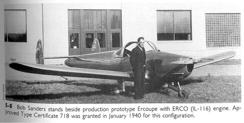

23 Jan 2025 16:35 - 23 Jan 2025 16:41 #3
Replied by Warren Hampton on topic topic change from Gascolator to spark plugs
this plane was using ERCO engine. see the shape of the nose. Note also no radios
Last edit: 23 Jan 2025 16:41 by Warren Hampton. Reason: Add more
23 Jan 2025 16:32 #4
Old type plug were replaced because of radio became used more.
