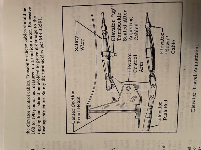

27 Nov 2024 22:08 #3
by Keith Whitcomb
Replied by Keith Whitcomb on topic Elevator cable tension
So if you are correct and the 160-190 needs to be divided by 12 to get pounds. Why would the next statement be “excessive rigging loads should be avoided to avoid damage to the fuselage structure?
I checked the cable tension prior to removal @ 70 ft pounds. They were very loose.
160-190 is a crazy high number, 8.33 to 15.8 foot pounds is a ridiculously low number.
I have installed the cables. I will check the 20 degrees of elevator up and do a final tension check and safety the turnbuckles tomorrow.
Happy Thanksgiving everyone!
27 Nov 2024 21:41 - 27 Nov 2024 21:45 #4
Replied by Warren Hampton on topic Elevator cable tension
That is in inch LBSD or 8.33 to 15.8 foot LBS
