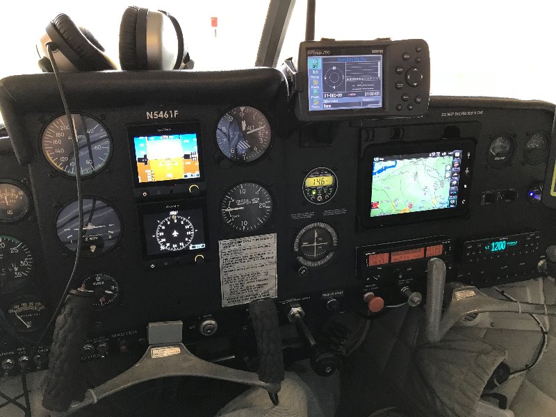

- Gordie Meade
- Posts: 139
29 Dec 2017 18:12 #4
by Gordie Meade
Replied by Gordie Meade on topic Fuel Gauge
Yes and I really like it. I found out I am burning more fuel at cruise than I thought. I thought I was burning 5 to 5 1/2 gal/hr but it turns out I am burning 6.5 gal/hr. At full throttle during climb, I burn over 8 gal/hr. It has caused me to change the numbers I use to flight plan. I REALLY like having a fuel remaining value at any time.
A couple of posts ago, I posted a picture of the installation. It looks great and works well.

- Gordie Meade
- Posts: 139
30 Nov 2017 19:27 #6
by Gordie Meade
Here's a picture with everything powered up.
