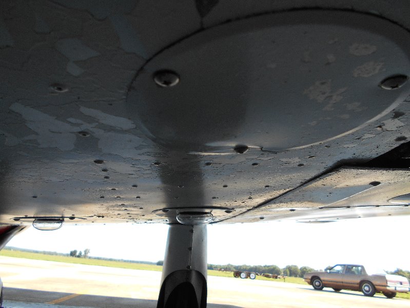

Yes. The air flow is better hot and cold. Flying an Alon in the summer can be unpleasant without them. It should take less than one hour and $20 to do it with no permanent changes to the airplane. Call me at 573-322-5747 if you would like to discuss it.

The Snap vents are model A-2-100. They are plastic. No scat tubing is needed. This is fast, effective and cheap. To me, it is a necessity.

- Henry Pasquet
10 Oct 2018 10:29 #18
by Henry Pasquet
Snap vents was created by Henry Pasquet
