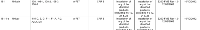

Hi all,
I am the happy owner of N9516V, Mooney M10 S/N 700006. The aircraft is based in La Ferte-Alais near Paris, France. AFAIK this is the only M10 flying in Europe, but maybe I am wrong.
I'd like to upgrade my EGT and CHT indicators by an EGT/CHT monitor such like Insight G1 or AeroSpace Logic ECT204 . Both companies refuse to add the M10 in their AML arguing there were too little number of aircrafts produced.
- Do you know other equivalent models that could be installed in the M10?
- Also what do you think of the ECT204 AML that mentions Univar ...M1 (screenshot attached)? Looks like a typo on the company name. Is there also a typo on M1 since I don't know such model?
Thanks!
Laurent

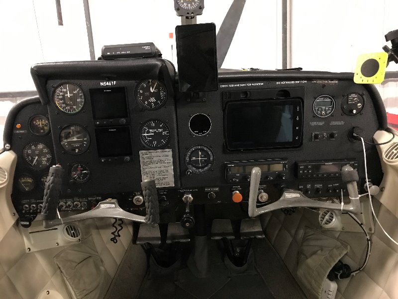

I took it that way, sorry if I came across as being critical.
I have been told by a couple of instructors that my M10 would now be a nice preliminary instrument trainer. Having flown in a little marginal weather, I don't think I would ever intentionally go into IMC conditions. The airplane would do it, but it would beat you to death in any serious turbulence. Still, it's nice to have the airplane be capable.

Very nice panel Gordie!
All I was trying to say was any 337 that is issued for a C/D model or newer should apply to an M10. Guess I should not post before my morning coffee.
And yes, I love LEDs and newer technology, though I do try to keep my moon coupe pretty stock.
