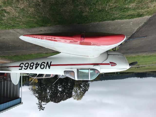

Looking at my first annual for my 1948 ERcoupe: N94865 415E S/N 4989. Would like to order some miscellaneous hardware like screws, nuts, bolts, hoses, etc that I expect to replace. I have seen some items on various Ercoupe websites like Univair, Spruce, and others. Not sure at all on types and sizes of screws, bolts, nuts, etc. Any suggestions would be appreciated.
