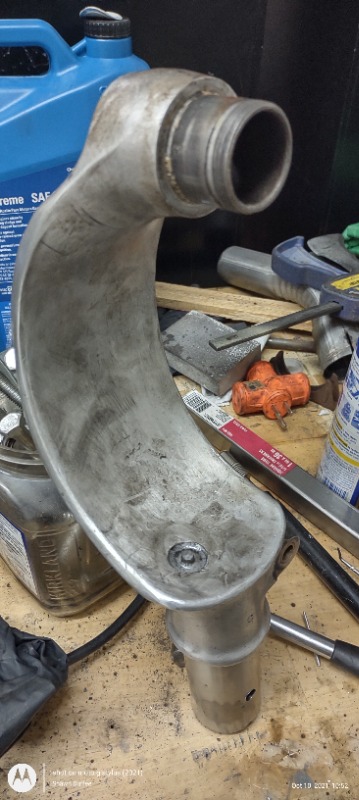

Shawn the bitch is heat transfer between the two parts. I use my torch to heat the fork with the shaft in the vise, a 2x2 block of wood and a heavy hammer at the ready. Here again two people one to heat and one to hammer the block on top of the collar.

Thank you for that. Not sure my wife will appreciate me doing that in the kitchen.
I would never have come up with that solution.

This is from the M-10 manual, Heat fork to 200-300F in water or oil to separate fork from cylinder,

Removing Fork from Nosegear was created by Shawn DUFFEE
