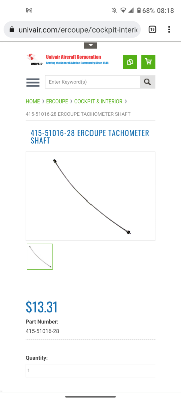

Shawn, $13.31 sound like the inner cable only. I have both starter an both !5 amp and 35 Amp gens when you need them $$ have no idea what they are going for. Warren

when I copy the part number and search Univair shows this $13.31 part. I think the only other part I have seen at Univair that cheap was a washer....Is that all I need? When compared to the 5 that show up in the link you shared, it is roughly 1/10th the price...

415-51016-28 or www.univair.com/search.php?search_query=...ter.aircraft=Ercoupe
