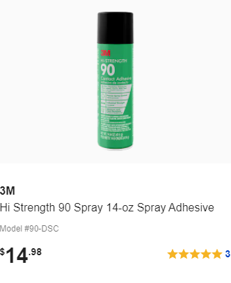

Lynn Nelsen and I replaced mine this past summer in my 'coupe. We used 3M 90 Hi Strength from Lowes. There are a couple of 3M types (77 and 90). Don't get the 77. It won't hold. The 3M 90 holds great, but takes at least 24 hours to fully cure. You will need a couple of cans to do the job.
