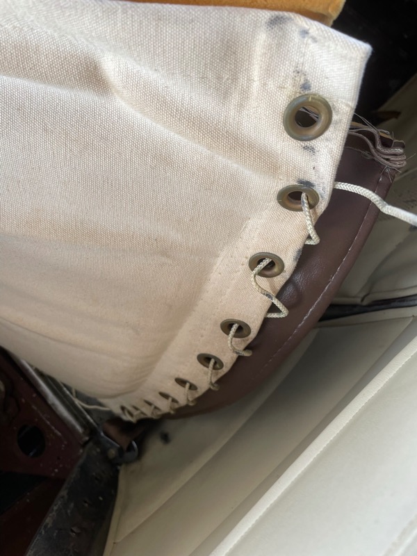

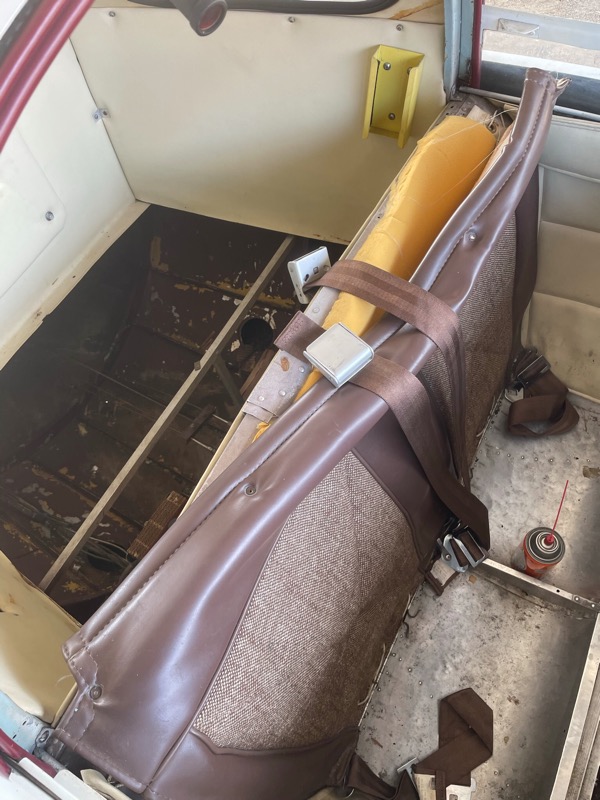

Some pictures.
- Jerry Nograsek
29 May 2023 06:53 #2
by Jerry Nograsek
Replied by Jerry Nograsek on topic Seat installation help
As Matt mentioned, on some, the seat back upholstery has the foam inserted in it, then the the seat back upholstery is laced around it circumference to the frame

the F-1 I work on has the same seat as my G model, the seat back is removable and is hinged at the bottom and held in place with 3 bolts or clevis pins. The earlier models the seat back is part of the airframe and seatback cushion is laced in place,
