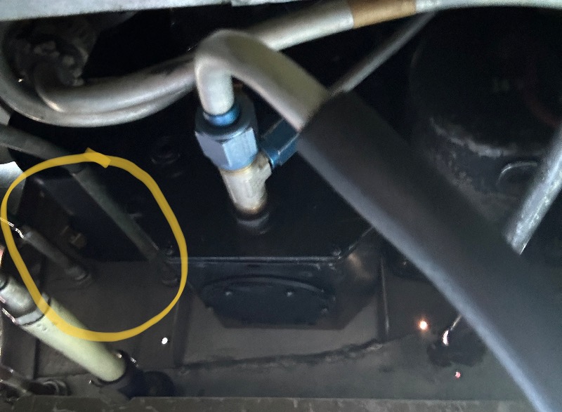

09 Dec 2023 13:17 #1
by Greg Harris
Replied by Greg Harris on topic Carb heat
Yea, I realized that after I posted question.
Thanks!
Thanks!
09 Dec 2023 10:27 #2
Replied by Matt Gunsch on topic Carb heat
the auto carb heat is on the air box,
08 Dec 2023 02:44 #3
Replied by Larry Snyder on topic Carb heat
Sorry but I can’t really see on the picture. Basically, any other connection to the carb heat flapper than the carb heat control would be auto carb heat.

07 Dec 2023 23:45 #4
by Greg Harris
Does this mean I don’t have the auto carb-heat? Is this where the bracket would be? See attachment.
Just curious what it looks like if hasn’t been removed.
