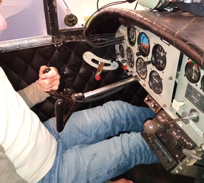

No, it’s the concave shape of those yokes that add a bunch of length. The pretzel yokes are flat. Those rams horns you have look like they are several inches deep.

Thanks- do I understand correctly that the shafts for the yokes I have now are too long by 6"? Is the correct shaft length given somwhere in the parts catalogue? I have a pair of pretzels I want put on and if the shafts need to be changed/corrected this is the time to do it.

Looks like those yokes add 6” over the original pretzel yokes.

I am having a problem when landing my Coupe, and would appreciate any help anyone can give. When flaring for landing, the yoke comes back so far that I literally cannot bring my left arm & wrist any farther back. Apart from being awkward and uncomfortable, it makes it very difficult to apply any aileron input, and seems neither right nor safe. The trim is always set for landing, the elevator up/down travel is set as per specs (confirmed at annual two months ago). The photo shows the situation as it is when flaring. I fly approach at 75-80 mph and am not trying to get the nose too high in the flare, I think, but it just seems wrong. Is there something in the setup of yoke travel that could help? If the seat back could go aft even a few inches it would help but the design won't allow that.
Any ideas/suggestions would be greatly appreciated! Many thanks.
