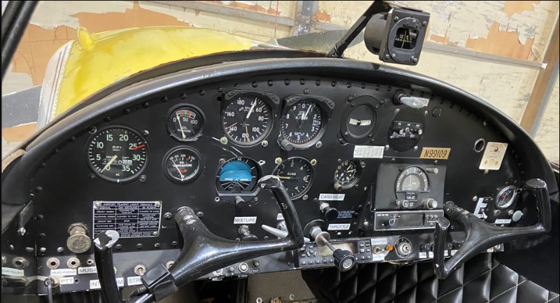

Replied by Ron Holmes on topic Magnetic Compass Location
I use it all the time. This is a shot of the airplane a day or two after I bought it. You can clearly see by the photo that there is not a single modern instrument on my panel. I learned with a chart and an E6B and a compass. I have a tablet with GPS software but I always find myself looking at the compass to make certain I am flying on the correct heading. My compass is an Airpath Instrument Company (I have forgotten the model #) They are still out there and they have a website where you can collect information..
