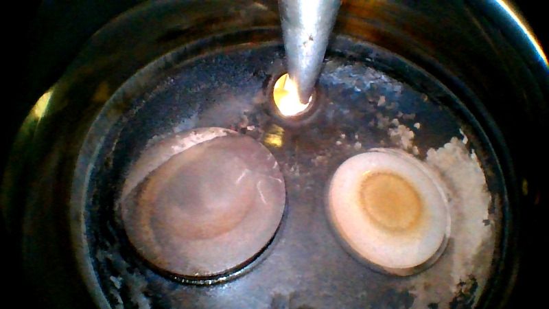

C-85 intake valve was created by Ronald Raty
My C-85 started running a little rough. A borescope evaluation revealed this in one of the cylinders. It looks like the intake valve is not seating and exhaust gasses are leaking past it. A compression test verified lower compression and air hissing out the intake manifold. Any suggestions on a fix, short of pulling the cylinder?
