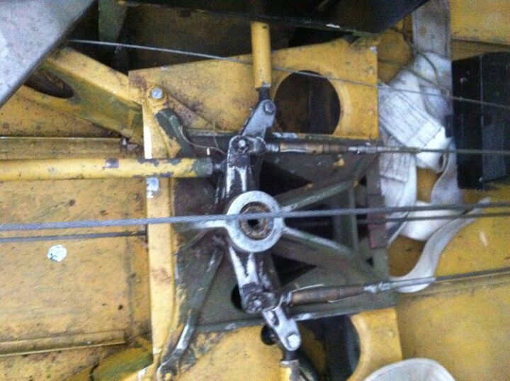

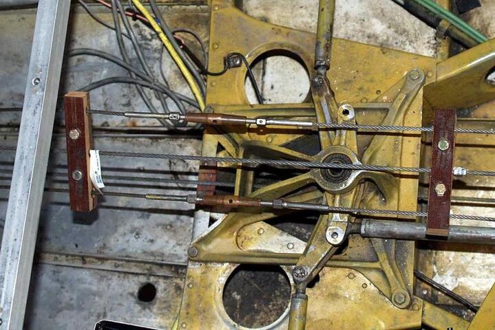

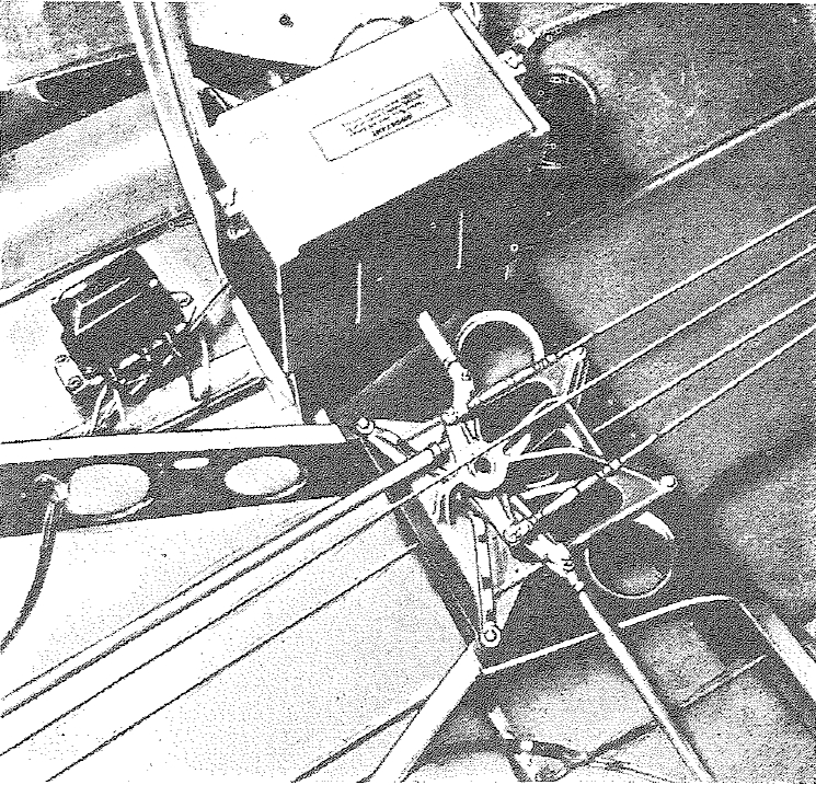

Thanks Matt & Ron! I found SB59 no drawings though. From your description in your reply and the photos I found it looks like a very straight forward job. Remove extensions, remount the clevis to the original cables still there, and boom. Done. I'm a bit of a visual learner. Takes me a moment to understand.
Manual B&W image
With Rudder Pedals
Without Rudder Pedals
Manual B&W image
With Rudder Pedals
