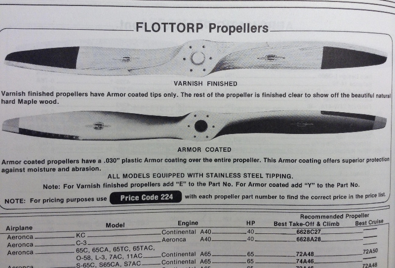

Turns out Univair sold Flottorp to an outfit called Tarver Propellers, which seems to be a one man shop in Nevada, and hasn't, so far, returned email or phone messages.

You've got an old, old one - the younger prop folks! Call Univair they bought Flottorp - Flottorp was one of the first prop makers dating back to the early 1900s. I don't recall there being a note taking them out of service.

An A&P, not my regular mechanic, has told me that all of the armor coated Flottorp propellers had been 'taken out of service' but neither he nor I can find any AD's or Service Bulletins or any other information on these propellers. Does anyone have any experience with these?
The propeller in question is a model number 74A50 with the .030" plastic coating, installed in 1983.
