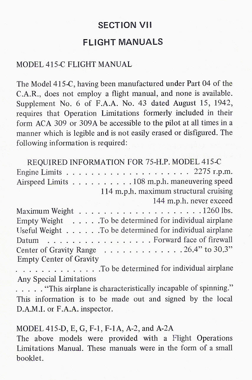

check the Type certificate Data sheet, it will tell you if you are required to have a POH, in the G model that is a yes. You must have a weight and balance, and the required placards and instrument limits listed in the type certificate for the airframe and engine.

Check out the official type certificate in the "files" section. It should specify the required placards for your mode. My 'coupe had the required placard printed on paper and taped to the dash. That must be OK as that was not a squawk during my first annual and the plane was found airworthy.

That’s all you need. The Ercoupes were built before a POH was required. That one page bulletin satisfies the requirement for operating limits.

I need operation limits to be legal
Where do I get it
Is this it? If so can I just print it and put it in airplane?
dev.ercoupe.org/images/415FlightManual.jpg

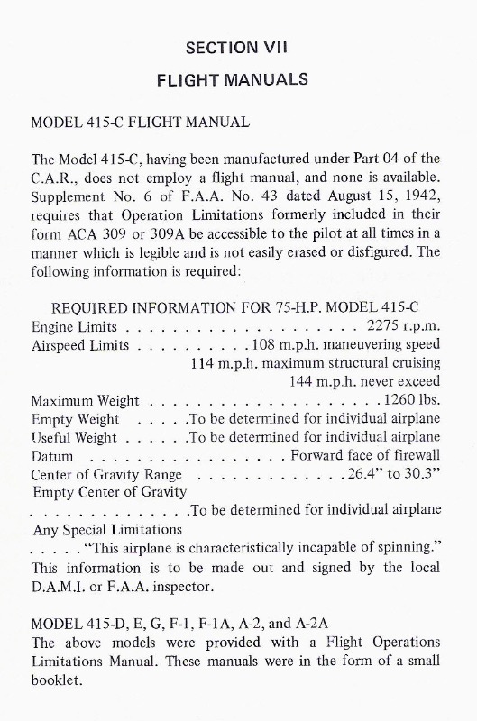

Where do I get it
