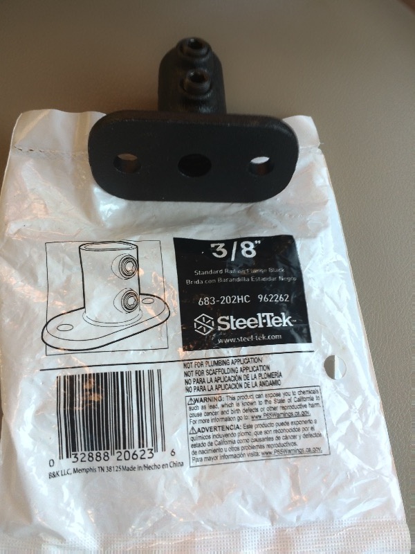

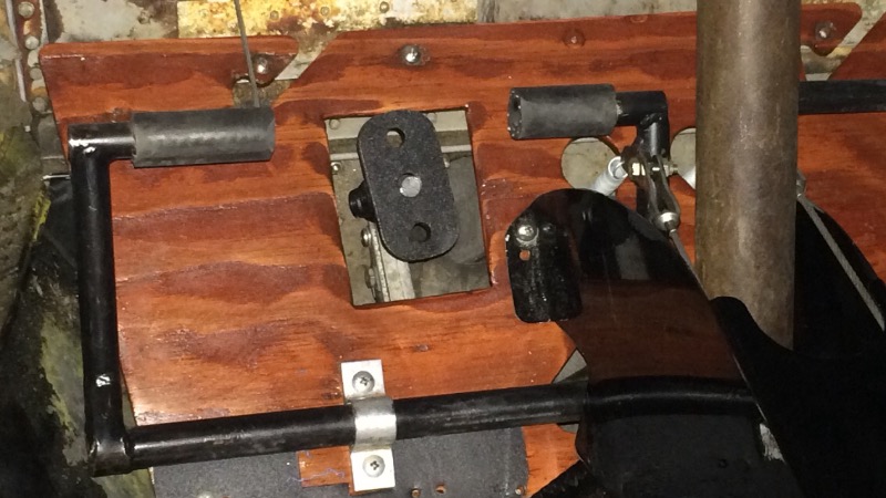

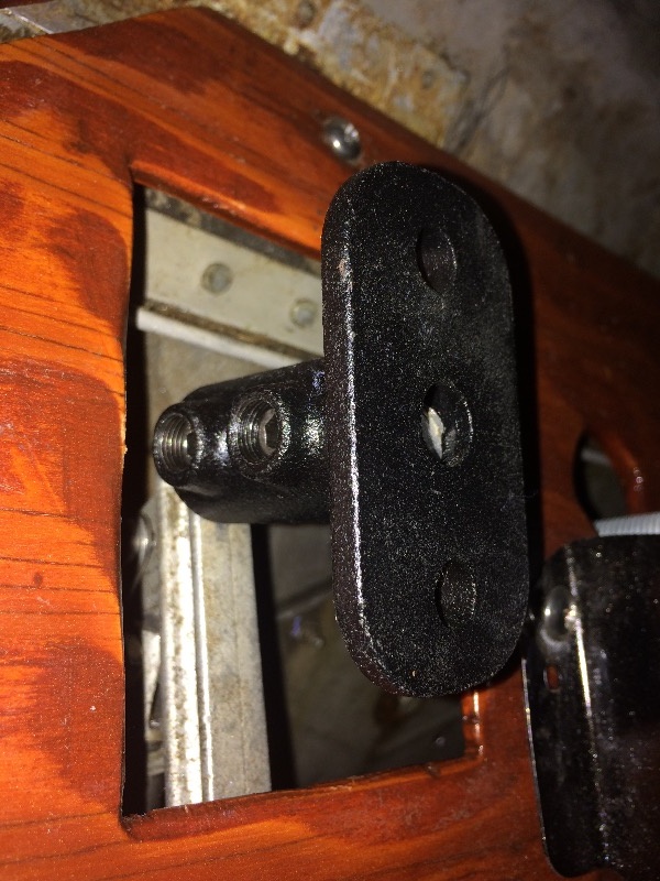

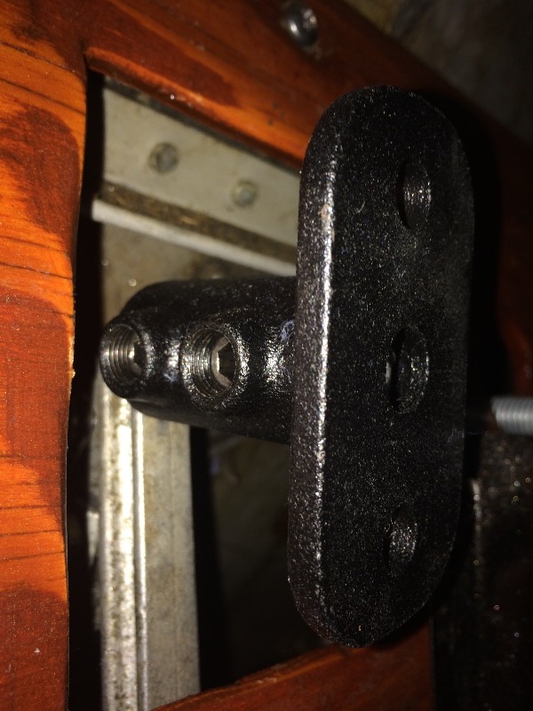

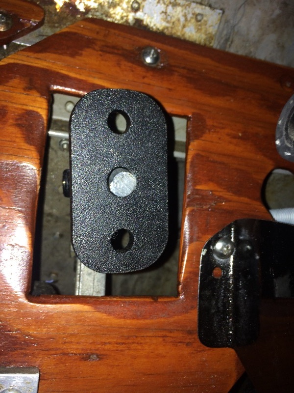

When we had the rudder pedals installed they cut off the actual brake pedal to make room for the pedals and just leave a round numb, this makes it very hard to push in the brakes and stop the airplane, as there’s no leverage or grip.
To fix this we purchased a flange with set screws from local hardware store and attached it to the brake pedal, it clears the rudder pedals and works good.
