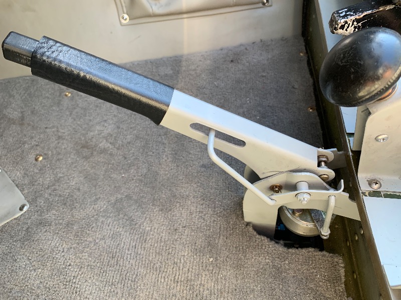

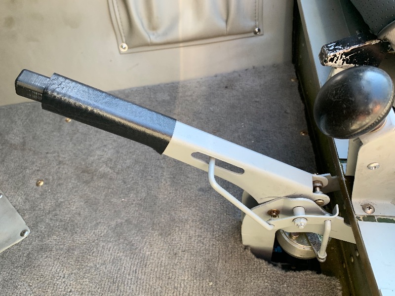

I will try to take a picture of it and post it here. As to how it worked out, when you pull the handle it's like you just hit the three wire.
Ok Here are brake pics

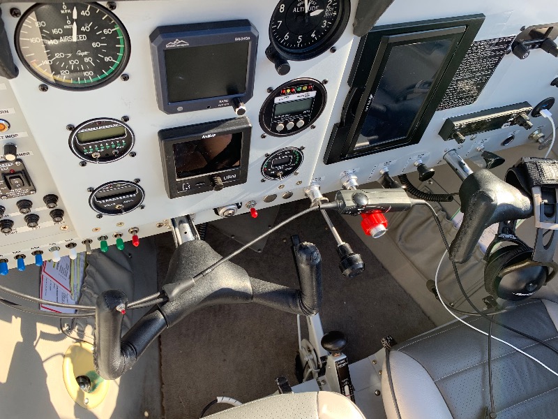

The 337 mounts under the instrument panel between the panel and the header tank it appears. The factory handbrake I am using mounts to the main spare frame just ahead of the trim. It is convenient. You pull up on it similar to an auto hand brake. The holes for mounting the brake control were already pre-drilled by the factory. So no modification is necessary, just bolt it in place and hook up the brake hose. I have the parts out being powder coated to match the rest of the interior.
