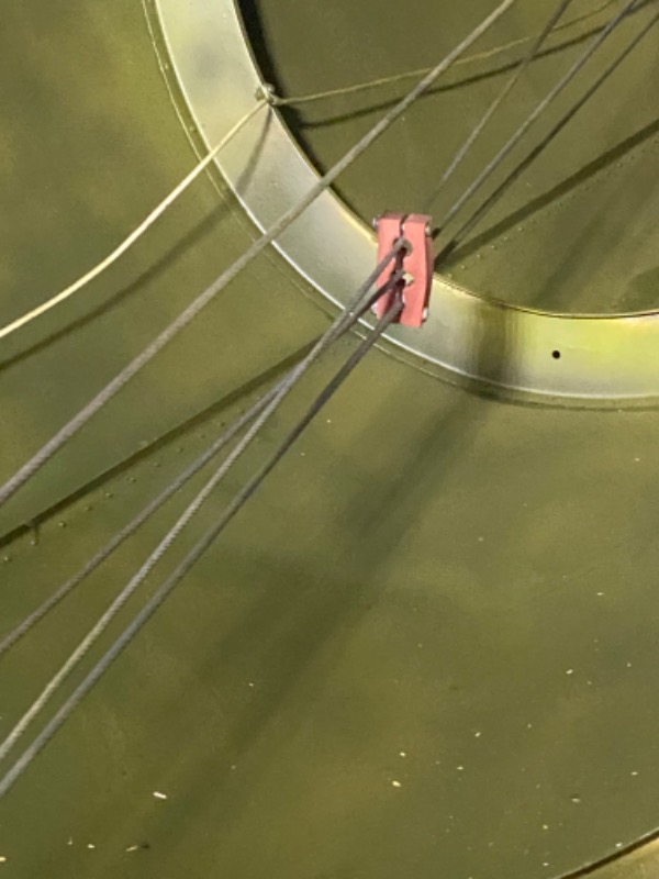

Here is how it stands now. The block is loose and will je adjusted to the cross point. The lower elevator cable os now no longer rubbing against the top of the mast amd aits just above the fairlead. So this part seems ok now.The block clamps to the lower elevator cable while the two rudders go through the block where the rudder cables cross? see photo

Pic two looks as if there.are two twists in cables. Let's start over. At the top of the mast are the rudder cables. Disconnect them the cables should be free to the block. At the block is the crossover point Hold both cables in both hands Left go to the right, Right go left Neither should be around the top or bottom cable. YOU HAVE TO DISCONN ...

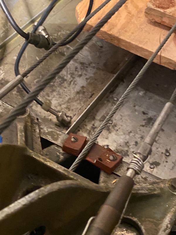

This is what it currently looks like with the lower elevator cable and rudder cable 'now' unwrapped.
The fairlead had a large indentation on it and now the rudder cable is in the indentation and has slightly down pressure. However, this pressure will be relieved if I pull the block forward or backwards.

I have to think about this.1) the fairlead should not be supporting the cable it is only protection. Close to is good. Now the block, Three holes one large = elev. cable. All three have to float for movement of the cables. I first said lower cable and your pic show that. Now the but... I do not remember seeing one that way. I think the block itself is only to space the rudder cable as they connect on the same plane. So I would leave it off until I saw which Elev. is the closest. Let me know, just be sure the rud. cable are crossing.

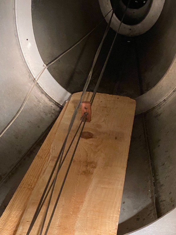

I followed your advise and uncrossed the lower elevator cable with the rudder. The lower elevator cable is now resting on the fairlead as it should! Good eye Warren!
Now I'm trying to figure out how the 'block' connects. The image attached is hard to decipher. It appears the lower cable connects with the rudder cable through the block and the upper fairlead crosses with the other rudder cable outside of the block. The top hole on the block is left empty. Is this correct?
