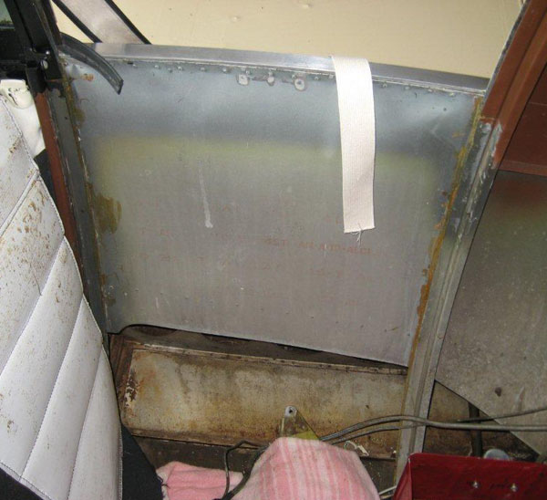

Replied by Brooks McNew on topic Replace sliding windows
Check out this page www.ercoupe.info/pmwiki.php/Main/SlidingWindows
I followed this to remove my windows and replace the welts. While out I used a plastic polishing kit (very similar to a headlight polishing kit) to clean up the windows and they're now about 95% as good as new. If you replace the welts, my best piece of advice would be to bite the bullet and remove the seat back before you start. You'll save time in the long run and do a better job with the seat back frame out of the way.
Looks like you may be missing the fuselage inner skins. These do a lot to protect the windows.

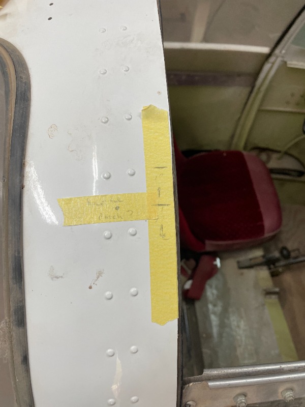

05 Jan 2024 19:27 - 05 Jan 2024 19:35 #3
Replied by Warren Hampton on topic Replace sliding windows
Mid/ center of the bow frame where the winds meet. so you workout both at the same spot. And I do have a set of Forney wing we could trade . But I would have to do the inspection on them Off a '57 F1

05 Jan 2024 17:52 #5
by Jack Pollack
Replied by Jack Pollack on topic Replace sliding windows
Thank you for your quick response.
I'll check on the wings.
Looking at the picture, am I on the right track?
Thanks!
Thanks!
