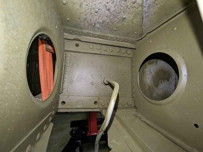

Another big concern of course was the infamous steel wing attachments on the center section main spar. Turned out that at some point, someone removed & beautifully refurbished the fuel tanks - and primed the front of the spar while they were at it. But the rear, being blocked by the landing gear, hasn't been touched. Borescope revealed the the rear steel hardware was surface corroded. Still airworthy, but needed attention to remain that way. So we removed the main gear one at a time to clean up the rear of the spar, apply corrosion treatment, and prime it.
Of course while you've got the MLG off you just KNOW you should rebuild the strut, replace the old stuff brake hoses, maybe replace some obviously nonstandard hardware she picked up over the years... It all seems to snowball.
The Alpha Aviation MLG strut STC and gear spacer STC are excellent kits and made a huge improvement.
Sorry for the different camera angles but this is the same center section area shown before and after.
It's not easy to shoot paint in this area especially once there's a good paint mist building up! Lots of evidence here of missed spots and weird overshoots.
Over the next few days I finally broke down and removed the windows and the fuselage inner skins that protect them. Wow - I should have done that in the beginning because it grants MUCH better access to the center section! Since these above photos were taken I cleaned out the rest of the center section and primed all the way across.
And of course it snowballs because... with the windows & inner skins out... now that I notice it these window welts look pretty ratty and it'll never be easier to replace them than it is right now.

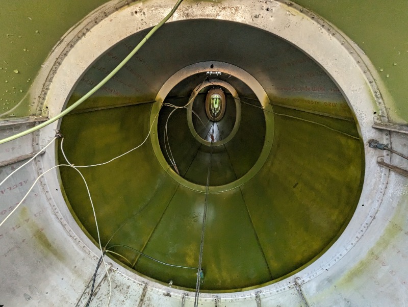

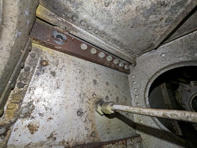

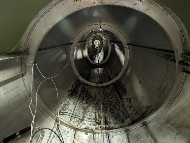

Update: scrubbed a lot of corrosion out but in some areas I couldn't get *everything* without going deep into sheet metal. Still, got it pretty clean in comparison and my A&P gave it his "good enough" approval. Scrubbed out the tail cone with Simple Green Extreme Aircraft Formula until water wouldn't break, alumiprepped the area, and primed.
The primer dried out looking a bit blotchy which is exaggerated even more with my camera flash, but apparently this isn't usual as it reacts with a non-perfect surface. Went 77 years with no primer at all so hopefully this is good enough to get some more decades out of the coupe.
Before...
Halfway done...
Before...
Halfway done...
