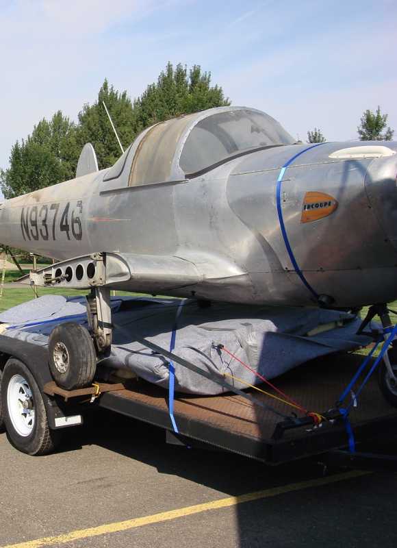

Hire a flatbed car hauler. Had to do that once after landing in a wheat field. Distance between outer edges of tires was 92 ΒΌ inches and the flatbed was 92. Plane squished perfectly on the bed, wings wrapped in blankets underneath.

Are you suggesting hooking the nose gear tow bar to a car? Check with your local Highway Patrol to see what they have to say about it. I would be curious.
It is fairly simple to load it on a car trailer. The MLG are spaced a little wider than most trailers so you will need a plank or steel channel clamped to the trailer bed right in front of the trailer wheels. The MLG sit on the plank. Use ramps to back the plane onto the trailer over the tongue.

road towing a coupe was created by planebum
can anyone advise if possible to road tow a coupe behind an auto (no wings or tail installed).
looking at a move of about 20 kilometers . if possible any advice on best method or practises would be appreciated. thanks
