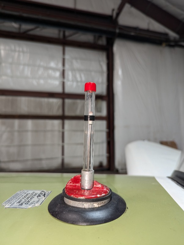

Just as a reference, here's what my fuel indicator looks like when the fuselage tank is "full" i.e. fuel is flowing out through the overflow pipe, sitting level on the ground.
I have an almost new plastic float and this is as high as it gets, unless you're in the air and put the nose up!
I put that little black strip of tape on the glass tube as a reference to the"full" level. Incidentally, there's still almost 2.5 gallons remaining in the fuselage tank when the float gauge bottoms out.

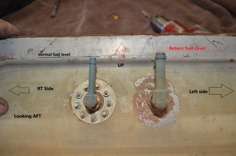

Replied by Matt Gunsch on topic Fuselage tank overflow elbow missing...
I posted photos of both, the Alon tank is the welded tank
