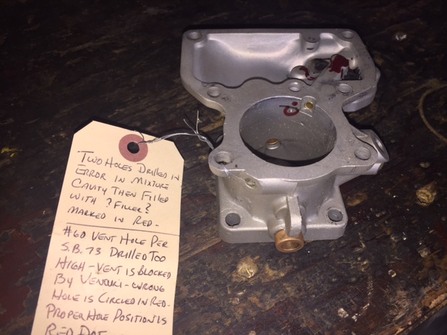

Included is a pic of what Unitech did. This is the upper half of the carb casting turned upside down. You can see that Bob circled in red the hole that was drilled in the incorrect location and then placed a red dot where it should have been drilled to fulfill the requirements of SB 73. Not only was it drilled in the wrong place but at the wrong angle and the result is that the mixture is too rich in the lower rpm ranges below about 1300 or so. He attached a tag explaining all this as you can see. This part had to be junked and he supplied a replacement for a very reasonable price I thought.
He also fixed the mismatched needle valve/seat so there's no more fuel leakage from over filled float bowl. With the new upper casting, the mixture control that most people say doesn't do anything below about 5000 feet altitude now works on the ground at my 1500 msl airport. It won't shut the engine down but it sure makes a difference when the mixture knob is pulled out and it is very precisely adjustable with the longer arm on it.
So, even though the whole affair was pretty spendy, as I mentioned, the confidence and peace of mind are worth it.
Chris

Oops. I somehow managed to submit this originally in the "Suggestions" forum so here it is where I originally meant for it to be posted. Trouble is, I can't get the pretty picture of the carburetor to come over with the text so if you want to see that, check out the posting under same heading in "Suggestion Box".
