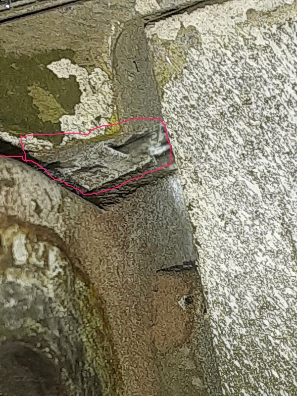

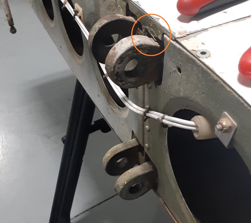

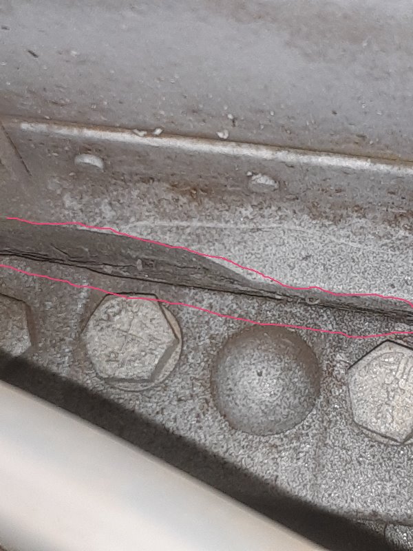

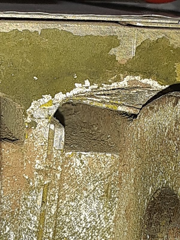

Wow that looks pretty bad. We just recovered the wings las winter so I know they are in good shape. I looked into the center section while the wings were off and they looked OK but next year an IA will have to sprinkle holy water on it. I am leaning towards installing the inspection ports bur have not yet decided which way to go.

Don't limit your inspection to just the center section spar. I recently did a annual on a F-1 and found exfoliation corrosion of the left wing upper spar cap. It would have been very hard to see without pulling the wing.
