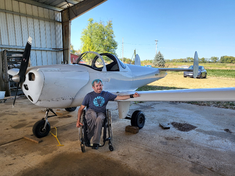

Hey everyone, excited to be a new member! I just bought N93687 and am looking forward to the amazing journeys ahead of me. I was fortunate enough for this one to have gone on the market only 100 miles away from me, and since I don't need hand controls to fly Ercoupes this is an ideal setup for me.
After a little avionics update and baggage compartment STC, she'll be ready to go!
