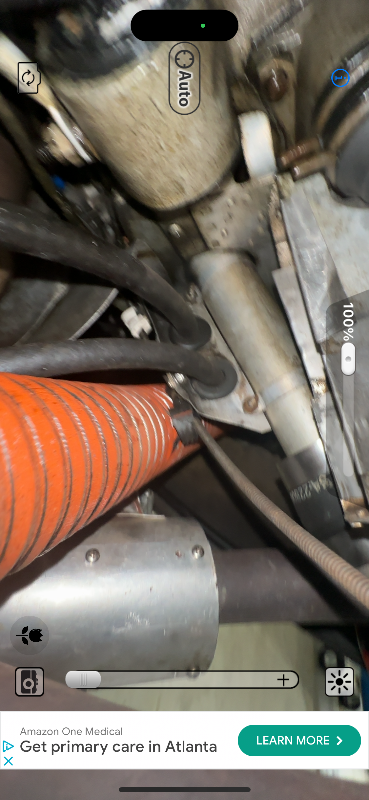

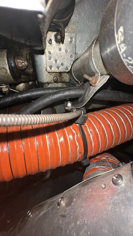

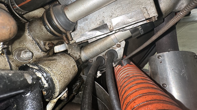

Replied by Matt Gunsch on topic Throttle and mixture cable support
ADel clamps should NOT be used on engine control cables others than for support. If you are using a Adel clamp as a anchor, you are asking for trouble in the future. The only clamps to use for anchors are a metal to metal boden cable clamp such as a AN742. Adel clamps lose their clamping force when the rubber insert dries out or gets oil soaked.

Replied by Nick Arquer on topic Throttle and mixture cable support
Thanks for the pics, I was planning a similar bracket location for my throttle cable. That mixture support is definitely interesting, but if it works.
Now I just need to figure out the panel to firewall support.
