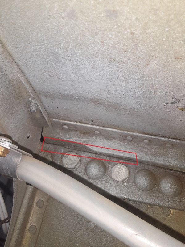

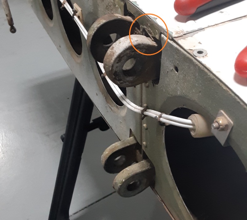

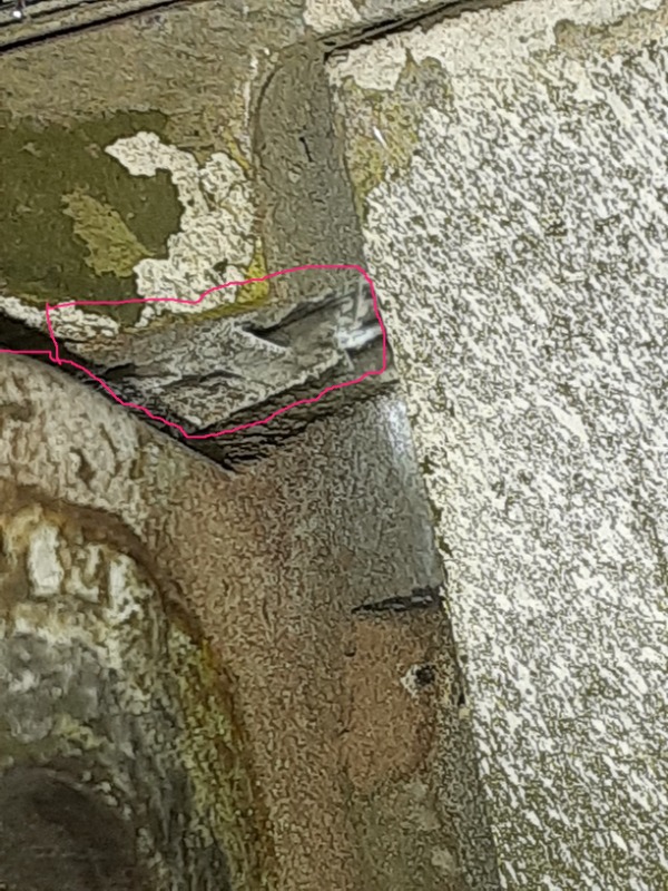

06 Mar 2021 22:42 #6
Replied by Matt Gunsch on topic AD 2002-26-02 Center Section Spar Corrosion Inspection
I recently did a annual on a F-1A and had we not pulled the wing, we would not have found the exfoliation corrosion that was on the upper spar cap under the wing attach fitting.
