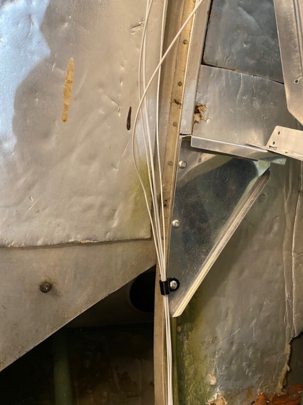

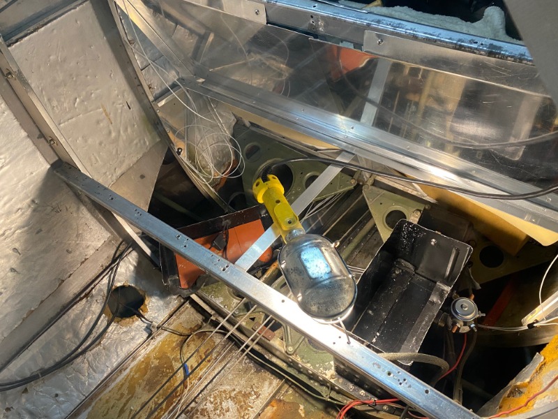

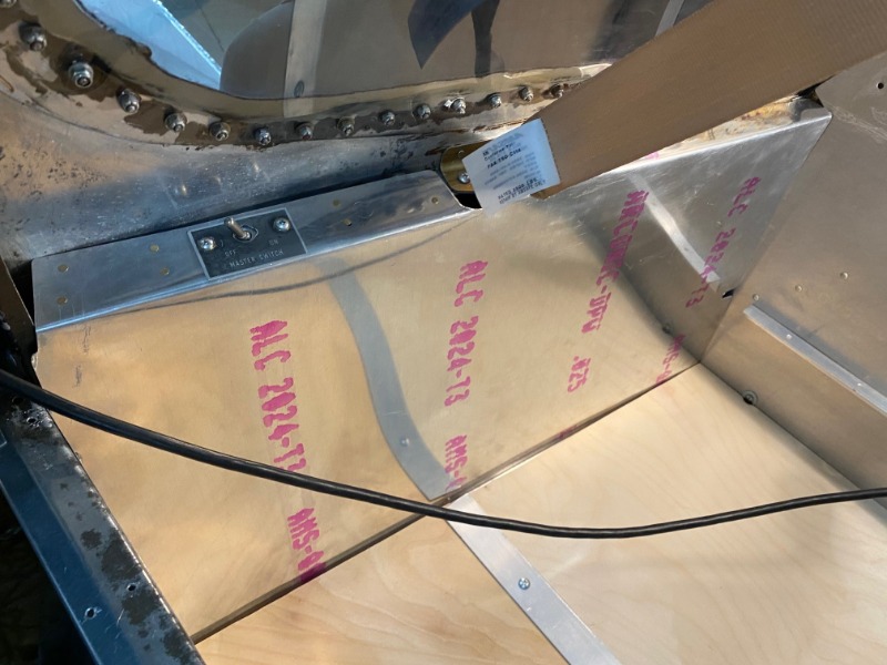

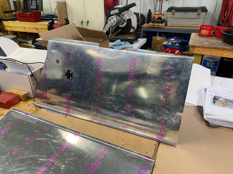

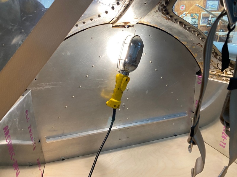

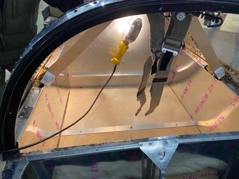

Putting final touches on the baggage compartment. The compartment is done... adding headset jack housings on the side walls as well as a battery charging point on the side wall. Very pleased with how it is coming out.
Some deviations from the STC:
-Aft bulkhead is a one piece panel which is secured with fasteners into nut plates (for easy access at Annual)
-Master switch moved to top of right side panel (along with the Master Relay switch STC), with doubler added for rigidity
-Headset jack housings added to side panels (not in pics yet)
-Battery charging jack added to side wall, with doubler added for sidewall rigidity
-horizontal angle extrusion added to aft wall and to seat back, with holes drilled... to be used to secure the cargo net
more to come tomorrow...
